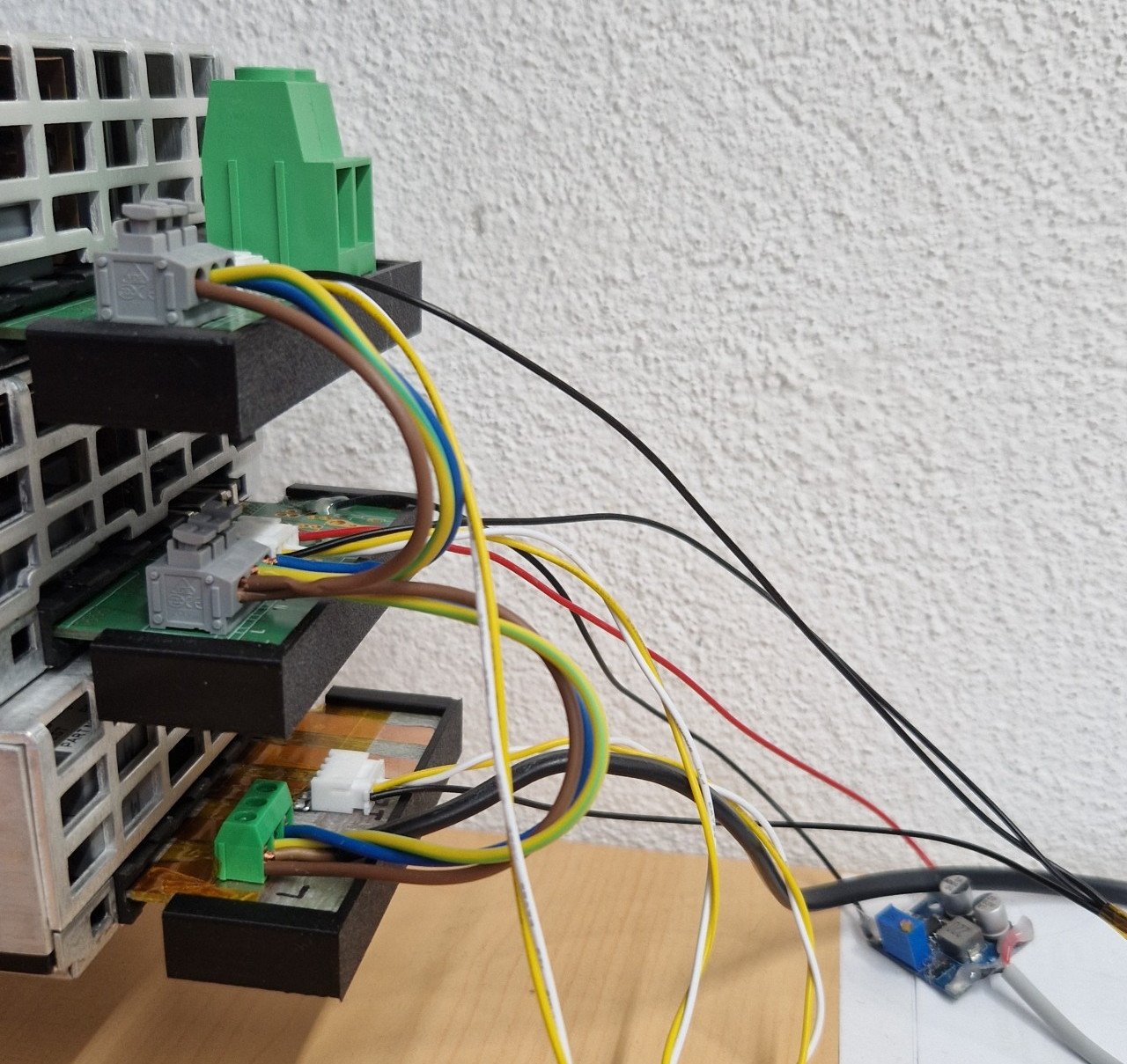

Kryt pre Eltek flatpak zdroje - https://www.printables.com/model/158173 ... oard-cover
