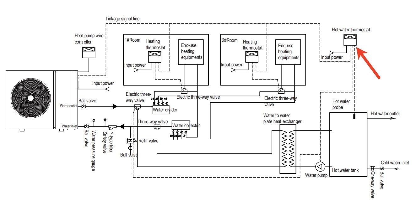

Tak mi přišla odpověď k WLTR a ohřevu vody:
The Nectar series doesn't have a DHW function. If you’d like to use it for hot water, you would need to add a DHW thermostat to communicate with the heat pump. This is also mentioned in the manual.
