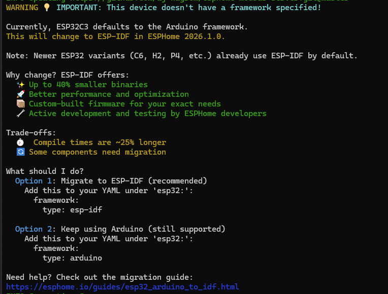

Ešte jedna zmena od 2026:
WARNING
IMPORTANT: This device doesn't have a framework specified!
Currently, ESP32C3 defaults to the Arduino framework.
This will change to ESP-IDF in ESPHome 2026.1.0.
Note: Newer ESP32 variants (C6, H2, P4, etc.) already use ESP-IDF by default.
Why change? ESP-IDF offers:
Up to 40% smaller binaries
Better performance and optimization
Custom-built firmware for your exact needs
Active development and testing by ESPHome developers
Trade-offs:
Compile times are ~25% longer
Some components need migration
What should I do?
Option 1: Migrate to ESP-IDF (recommended)
Add this to your YAML under 'esp32:':
framework:
type: esp-idf
Option 2: Keep using Arduino (still supported)
framework:
type: arduino
Need help? Check out the migration guide:
https://esphome.io/guides/esp32_arduino_to_idf.html
WARNING
Trade-offs:
What should I do?
framework:
type: esp-idf
framework:
type: arduino

A po lopatě mi vysvětli, jakej je rozdíl mezi arduino a ESP-IDF, když bych pouze provedl změnu v yaml tady a vše ostatní nechal tak jak je... Díky!
Kód: Vybrat vše
esp32:
board: esp32dev
framework:
type: arduino #ESP-IDF
version: recommended
- Příspěvky: 4288
- Reputace:991
- Výkon panelů [Wp]: 10650
Re: ESPhome 2025.7 OTA breaking changes
Pozri si vyššie Trade-offs a ESP-IDF offers.jakej je rozdíl mezi arduino a ESP-IDF
