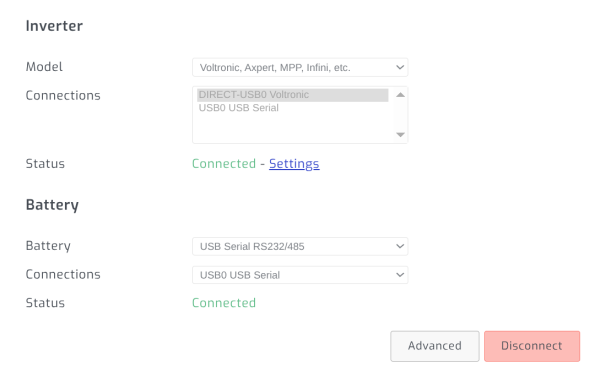

Re: Solar Assistant
root@solar-assistant:~# usbreset 001/006
Resetting USB Serial ... ok
log:
Jul 15 14:20:15 solar-assistant influx-bridge[651]: [Tue Jul 15 16:20:15] [inverter:voltronic:driver] Scheduled inverter query qdop failed: rejected: (NAK
Jul 15 14:20:29 solar-assistant kernel: ch341-uart ttyUSB1: ch341-uart converter now disconnected from ttyUSB1
Jul 15 14:20:29 solar-assistant kernel: ch341 1-1.3:1.0: device disconnected
Jul 15 14:20:29 solar-assistant influx-bridge[651]: [Tue Jul 15 16:20:29] [bms:serial:connection] Closing serial port.
Jul 15 14:20:29 solar-assistant influx-bridge[651]: [Tue Jul 15 16:20:29] GenServer SolarAssistant.BMS.Serial.Driver.Connection terminating
Jul 15 14:20:29 solar-assistant influx-bridge[651]: ** (MatchError) no match of right hand side value: {:error, :ebadf}
Jul 15 14:20:29 solar-assistant influx-bridge[651]: (solar_assistant 1.9.15) lib/solar_assistant/bms/serial/driver/connection.ex:36: SolarAssistant.BMS.Serial.Driver.Connection.handle_call/3
Jul 15 14:20:29 solar-assistant influx-bridge[651]: (stdlib 4.2) gen_server.erl
:gen_server.try_handle_call/4
:gen_server.handle_msg/6
Jul 15 14:20:29 solar-assistant influx-bridge[651]: (stdlib 4.2) proc_lib.erl:240: :proc_lib.init_p_do_apply/3
Jul 15 14:20:29 solar-assistant influx-bridge[651]: Last message (from SolarAssistant.BMS.Serial.Driver): {:submit, %SolarAssistant.BMS.Serial.Driver.Command{header: %{adr: 2, cid1: 70, cid2: 66, info: [1], ver: 34}, metrics: nil, raw: "~22024642E00201FD32\r"}}
Jul 15 14:20:29 solar-assistant kernel: usb 1-1.3: reset full-speed USB device number 6 using dwc_otg
Jul 15 14:20:29 solar-assistant influx-bridge[651]: [Tue Jul 15 16:20:29] [bms:serial] [error] Failed to open ttyUSB1: enoent. Retrying in 15s
Jul 15 14:20:29 solar-assistant kernel: ch341 1-1.3:1.0: ch341-uart converter detected
Jul 15 14:20:29 solar-assistant kernel: usb 1-1.3: ch341-uart converter now attached to ttyUSB0
Jul 15 14:20:32 solar-assistant ModemManager[464]: <info> [base-manager] couldn't check support for device '/sys/devices/platform/soc/3f980000.usb/usb1/1-1/1-1.3': not supported by any plugin
Jul 15 14:20:38 solar-assistant influx-bridge[651]: [Tue Jul 15 16:20:38] GET /grafana/api/datasources/proxy/1/query
.... Po nejakom case proste musim stlacit web tlacitka Disconect ... Connect.
potom to ide OK.

Zda sa ze problem vypadavania USB je vyrieseny.
Odsledovane uz dlhsiu dobu.
Chyba bola pravdepodobne na poskodenom filesysteme.
Po oprave fsck -fy -C0 /dev/sda1 to slape ako ma.
Cely adresar /var je teraz primontovany na usb kluc.
Takze na flash pameti je len system , ziaden zapis.
Zatial sa mi nestalo ze by zber dat vypadol.
FS za vzdy poskodil ked sa vypol RP. Spravne musi byt najskor shutdown.
Lenze pri vypadku elektriny to jednoducho vypadlo.
Preto som zacal napajat RP priamo z bateriek. Treba k tomu menic na DC-DC 60V->5V.
