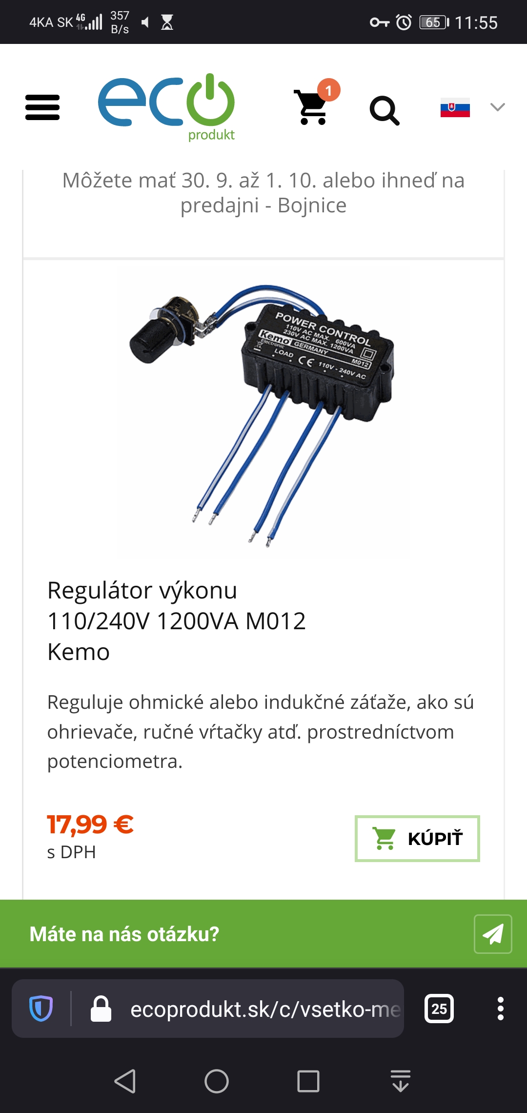

Názor na toto? Mohlo by to pomôcť? https://ecoprodukt.sk/p/83453-regulator ... kemo-22471
