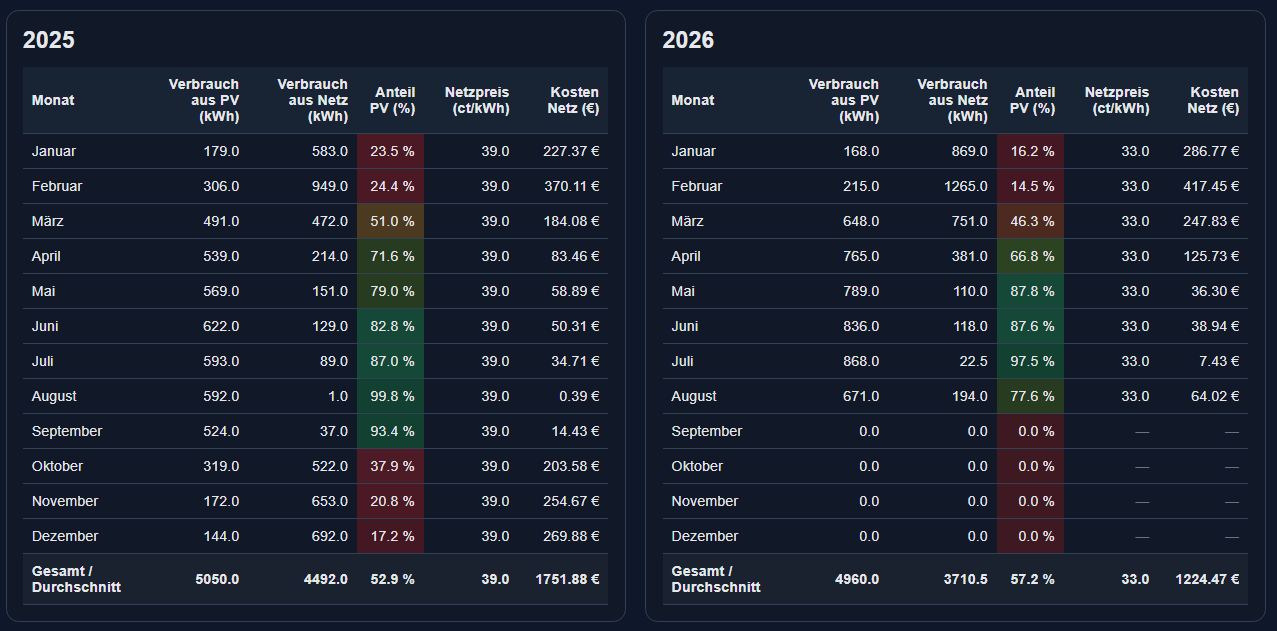

SRPEN 2026
https://mereni5.pythonanywhere.com/
Za srpen : 671 kWh z FV a 194 kWh z DS
Z toho e-auto : 129 kWh z FV a 194 kWh z DS
