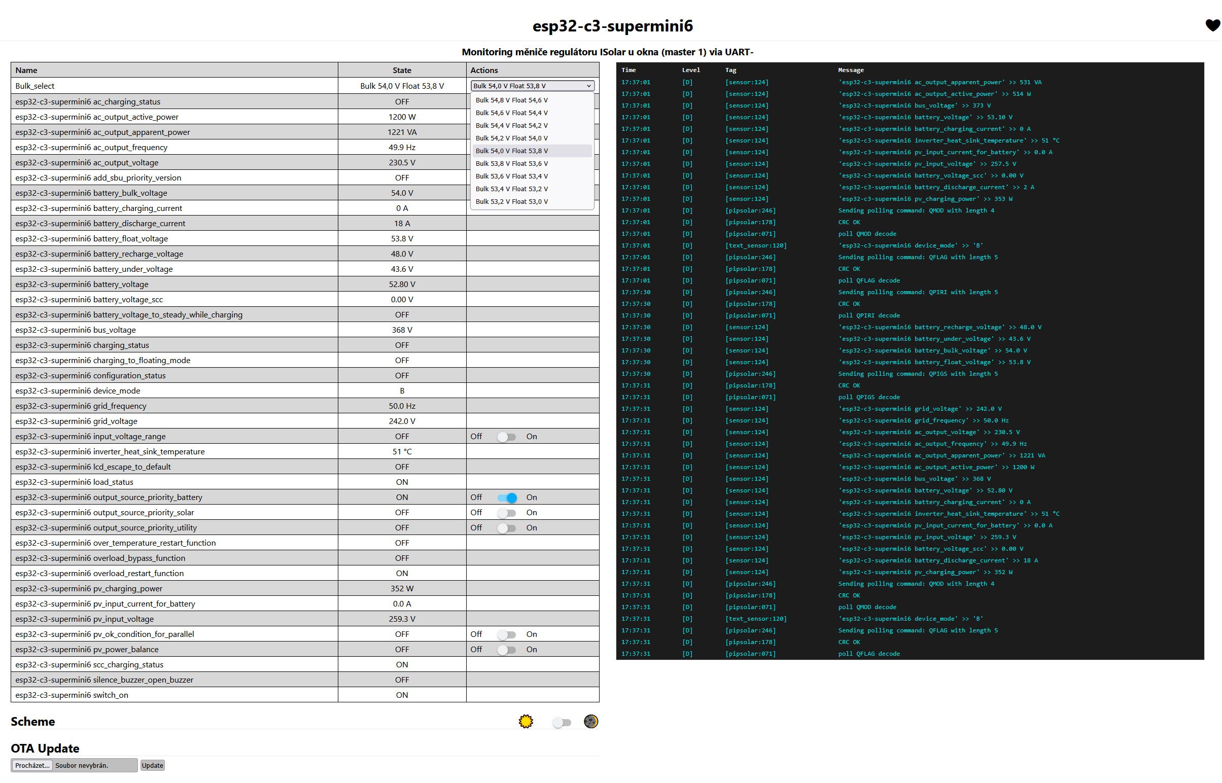

Od https://github.com/syssi/esphome-pipsolar yaml používám a nezaregistroval jsem problém. Jen jsem k tomu originálnímu přidal pár řádek, abych mohl z HA měnit napětí regulátoru:
A tam jsem si bokem pro těch pár zapisovaných hodnot CRC spočítal. Upravený je pak takový:
Kód: Vybrat vše
# Warning:
# https://github.com/syssi/esphome-pipsolar
# If you configure a lot of the possible sensors etc. it could be that you run
# out of memory (on esp8266). If you configure nearly all sensors etc. you run
# in a stack-size issue. In this case you have to increase stack size!
#  https://github.com/esphome/issues/issues/855
substitutions:
  friendly_name: esp32-c3-supermini6
  device_description: "Monitoring měniče regulátoru ISolar u okna (master 1) via UART-TTL"
  tx_pin: GPIO1
  rx_pin: GPIO0
esphome:
  name_add_mac_suffix: false
  project:
    version: '1.0'
esp32:
  board: esp32-c3-devkitm-1
#  board: wemos_d1_mini32
  framework:
#    type: arduino
    type: esp-idf
# Enable logging
logger:
# Enable Home Assistant API
api:
#  reboot_timeout: 0s
#  encryption:
#    key: "vvvvvvvvvvvvvvvvvvvvvvvv"
ota:
  platform: esphome
#  password: "xxxxxxxxxxxxxxxxxxxxxxxxxxx"
wifi:
  ssid: !secret wifi_ssid
  min_auth_mode: WPA2
# Optional manual IP
  manual_ip:
    static_ip: 192.168.0.67
    gateway: 192.168.0.1
    subnet: 255.255.255.0
  ap:
    ssid: "esp32-c3-supermini6"
    password: "xxxxxxxxxxxxxxxxxx6"
web_server:
 port: 80
# Allow provisioning Wi-Fi via serial
improv_serial:
# In combination with the `ap` this allows the user
# to provision wifi credentials to the device via WiFi AP.
captive_portal:
#dashboard_import:
#  package_import_url: github://esphome/firmware/esphome-web/esp32c3.yaml@v2
#  import_full_config: true
# Sets up Bluetooth LE (Only on ESP32) to allow the user
# to provision wifi credentials to the device.
#esp32_improv:
#  authorizer: none
# To have a "next url" for improv serial
#web_server:
uart:
  baud_rate: 2400
  tx_pin: ${tx_pin}
  rx_pin: ${rx_pin}
#  debug:
#    direction: BOTH
#    dummy_receiver: false
#    after:
#      delimiter: "\r"
#    sequence:
#      - lambda: UARTDebug::log_string(direction, bytes);
# zápis do měniče dle https://github.com/syssi/esphome-pipsolar/blob/main/tests/esp8266-test-protocols.yaml
#      - uart.write: [0x51, 0x4D, 0x4F, 0x44, 0x49, 0xC1, 0x0D]  # QMODI\xc1\r
#      - delay: 1s
# příkazy dle https://forums.aeva.asn.au/uploads/293/HS_MS_MSX_RS232_Protocol_20140822_after_current_upgrade.pdf
# PCVV<nn.n><cr>: Setting battery C.V. (constant voltage) charging voltage
# Computer: PCVV <nn.n><CRC><cr>
# Device: (ACK<CRC><cr> if device accepts this command, otherwise, responds (NAK<CRC><cr>
# nn.n: 48.0V ~ 58.4V for 48V unit
# PBFT<nn.n><cr>: Setting battery float charging voltage
# Computer: PBFT <nn.n><CRC><cr>
# dle https://crccalc.com/ to vypadá, že u CRC se jedná o CRC-16, podle CRC-16/XMODEM. Na dané stránce si těch pár požadovaných CRC hodnot pro potřebné příkazy nechám spočítat.
# nastavení bulk na 54.4 V = PCVV54.8
#      - uart.write: [0x50, 0x43, 0x56, 0x56, 0x35, 0x34, 0x2E, 0x38, 0xF0, 0xB3, 0x0D]  # PCVV54.8<CRC>\r
# nastavení bulk na 53.8 V = PCVV53.8
#      - uart.write: [0x50, 0x43, 0x56, 0x56, 0x35, 0x33, 0x2E, 0x38, 0x75, 0x23, 0x0D]  # PCVV53.8<CRC>\r
# nastavení bulk na 53.6 V = PCVV53.6
#      - uart.write: [0x50, 0x43, 0x56, 0x56, 0x35, 0x33, 0x2E, 0x36, 0x94, 0xED, 0x0D]  # PCVV53.6<CRC>\r
# nastavení bulk na 53.4 V = PCVV53.4
#      - uart.write: [0x50, 0x43, 0x56, 0x56, 0x35, 0x33, 0x2E, 0x34, 0xB4, 0xAF, 0x0D]  # PCVV53.4<CRC>\r

select:
  - platform: template
    optimistic: true
    options:
      - Bulk 54,8 V Float 54,6 V
      - Bulk 54,6 V Float 54,4 V
      - Bulk 54,4 V Float 54,2 V
      - Bulk 54,2 V Float 54,0 V
      - Bulk 54,0 V Float 53,8 V
      - Bulk 53,8 V Float 53,6 V
      - Bulk 53,6 V Float 53,4 V
      - Bulk 53,4 V Float 53,2 V
      - Bulk 53,2 V Float 53,0 V
    initial_option: Bulk 54,0 V Float 53,8 V
    on_value:
      then:
      - if:
          condition:
            lambda: |-
              return (id(bulk_select).active_index() == 0);
          then:
          - logger.log: "54,8"
          - uart.write:
              data: [0x50, 0x42, 0x46, 0x54, 0x35, 0x34, 0x2E, 0x36, 0xF7, 0x1B, 0x0D]  # nejprve sníží napětí float na 54.6V: PBFT54.6<CRC>\r
          - delay: 1s
          - uart.write:
              data: [0x50, 0x43, 0x56, 0x56, 0x35, 0x34, 0x2E, 0x38, 0xF0, 0xB3, 0x0D]  # potom sníží napětí bulk na 54.8V: PCVV54.8<CRC>\r
          - delay: 1s
      - if:
          condition:
            lambda: |-
              return (id(bulk_select).active_index() == 1);
          then:
          - logger.log: "54,6"
          - uart.write:
              data: [0x50, 0x42, 0x46, 0x54, 0x35, 0x34, 0x2E, 0x34, 0xD7, 0x59, 0x0D]  # nejprve sníží napětí float na 54.4V: PBFT54.4<CRC>\r
          - delay: 1s
          - uart.write:
              data: [0x50, 0x43, 0x56, 0x56, 0x35, 0x34, 0x2E, 0x36, 0x11, 0x7D, 0x0D]  # potom sníží napětí bulk na 54.6V: PCVV54.6<CRC>\r
          - delay: 1s
      - if:
          condition:
            lambda: |-
              return (id(bulk_select).active_index() == 2);
          then:
          - logger.log: "54,4"
          - uart.write:
              data: [0x50, 0x42, 0x46, 0x54, 0x35, 0x34, 0x2E, 0x32, 0xB7, 0x9F, 0x0D]  # nejprve sníží napětí float na 54.2V: PBFT54.2<CRC>\r
          - delay: 1s
          - uart.write:
              data: [0x50, 0x43, 0x56, 0x56, 0x35, 0x34, 0x2E, 0x34, 0x31, 0x3F, 0x0D]  # potom sníží napětí bulk na 54.4V: PCVV54.4<CRC>\r
          - delay: 1s
      - if:
          condition:
            lambda: |-
              return (id(bulk_select).active_index() == 3);
          then:
          - logger.log: "54,2"
          - uart.write:
              data: [0x50, 0x42, 0x46, 0x54, 0x35, 0x34, 0x2E, 0x30, 0x97, 0xDD, 0x0D]  # nejprve sníží napětí float na 54.0V: PBFT54.0<CRC>\r
          - delay: 1s
          - uart.write:
              data: [0x50, 0x43, 0x56, 0x56, 0x35, 0x34, 0x2E, 0x32, 0x51, 0xF9, 0x0D]  # potom sníží napětí bulk na 54.2V: PCVV54.2<CRC>\r
          - delay: 1s
      - if:
          condition:
            lambda: |-
              return (id(bulk_select).active_index() == 4);
          then:
          - logger.log: "54,0"
          - uart.write:
              data: [0x50, 0x42, 0x46, 0x54, 0x35, 0x33, 0x2E, 0x38, 0x93, 0x45, 0x0D]  # nejprve sníží napětí float na 53.8V: PBFT53.8<CRC>\r
          - delay: 1s
          - uart.write:
              data: [0x50, 0x43, 0x56, 0x56, 0x35, 0x34, 0x2E, 0x30, 0x71, 0xBB, 0x0D]  # potom sníží napětí bulk na 54.0V: PCVV54.0<CRC>\r
          - delay: 1s
      - if:
          condition:
            lambda: |-
              return (id(bulk_select).active_index() == 5);
          then:
          - logger.log: "53,8"
          - uart.write:
              data: [0x50, 0x42, 0x46, 0x54, 0x35, 0x33, 0x2E, 0x36, 0x72, 0x8B, 0x0D]  # nejprve sníží napětí float na 53.6V: PBFT53.6<CRC>\r
          - delay: 1s
          - uart.write:
              data: [0x50, 0x43, 0x56, 0x56, 0x35, 0x33, 0x2E, 0x38, 0x75, 0x23, 0x0D]  # potom sníží napětí bulk na 53.8V: PCVV53.8<CRC>\r
          - delay: 1s
      - if:
          condition:
            lambda: |-
              return (id(bulk_select).active_index() == 6);
          then:
          - logger.log: "53,6"
          - uart.write:
              data: [0x50, 0x42, 0x46, 0x54, 0x35, 0x33, 0x2E, 0x34, 0x52, 0xC9, 0x0D]  # nejprve sníží napětí float na 53.4V: PBFT53.4<CRC>\r
          - delay: 1s
          - uart.write:
              data: [0x50, 0x43, 0x56, 0x56, 0x35, 0x33, 0x2E, 0x36, 0x94, 0xED, 0x0D]  # potom sníží napětí bulk na 53.6V: PCVV53.6<CRC>\r
          - delay: 1s
      - if:
          condition:
            lambda: |-
              return (id(bulk_select).active_index() == 7);
          then:
          - logger.log: "53,4"
          - uart.write:
              data: [0x50, 0x42, 0x46, 0x54, 0x35, 0x33, 0x2E, 0x32, 0x32, 0x0F, 0x0D]  # nejprve sníží napětí float na 53.2V: PBFT53.2<CRC>\r
          - delay: 1s
          - uart.write:
              data: [0x50, 0x43, 0x56, 0x56, 0x35, 0x33, 0x2E, 0x34, 0xB4, 0xAF, 0x0D]  # potom sníží napětí bulk na 53.4V: PCVV53.4<CRC>\r
          - delay: 1s
      - if:
          condition:
            lambda: |-
              return (id(bulk_select).active_index() == 8);
          then:
          - logger.log: "53,2"
          - uart.write:
              data: [0x50, 0x42, 0x46, 0x54, 0x35, 0x33, 0x2E, 0x30, 0x12, 0x4D, 0x0D]  # nejprve sníží napětí float na 53.0V: PBFT53.0<CRC>\r
          - delay: 1s
          - uart.write:
              data: [0x50, 0x43, 0x56, 0x56, 0x35, 0x33, 0x2E, 0x32, 0xD4, 0x69, 0x0D]  # potom sníží napětí bulk na 53.2V: PCVV53.2<CRC>\r
          - delay: 1s
#-----konec-----------------------------------------
