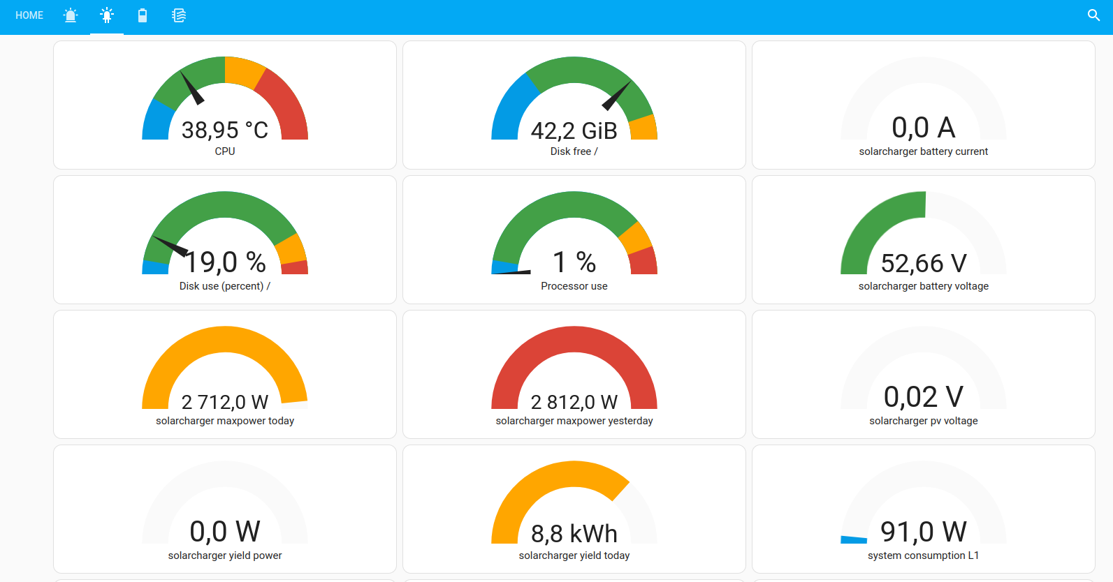

AJ mne Victron pise v HA / solar charger battery current /.
