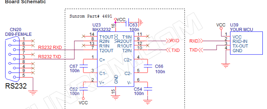

Re: Prevodnik rs232<->TTL
Je to zapojene takto?
DanoP: ano je to takto zapojene, akorat nevim ty kapacity kondiku.

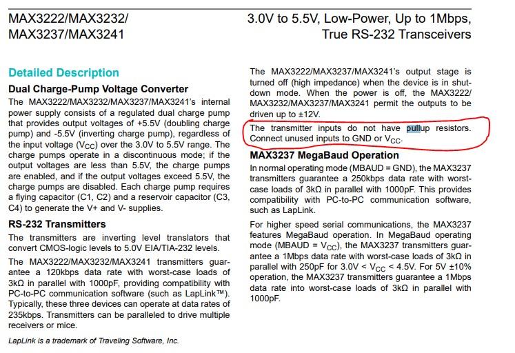

- DanoP
- Příspěvky: 949
- Reputace:216
- Bydliště: Trnava, Slovensko
To znamena ze kmita, lebo kludovy odber ma byt do 1mA a to ho urcite nezahreje. To asi nebude original chip od TI, alebo MAX. Skusit dat nejaky pull-up alebo pull down odpor na R2IN aby mal definovanu uroven?
inak nepotesim ten problem riseili aj na TI https://e2e.ti.com/support/interface/f/138/t/705802 a fungovalo to az po vymene cipu (cize nevyriesili).
Podobny problem bol as MAX232 a vraj pomohlo toto:
Just solved this overheating problem on a batch of max232 chips using a couple of resistors. See the input pins 10 and 11 http://www.maximintegrated.com/en/produ ... AX232.html and click the picture to enlarge. There are supposed to be 400k resistors internally but measuring the resistance to pin 16, I got 40 megohms on this batch. So these pins will be floating and picking up RF and oscillating at a high frequency which in turn will be drawing a lot of current and making the chip hot. I used a couple of 390k resistors as pullups, but anything from 10k to 400k would probably do. Might be worth adding 5K pulldowns on pins 13 and 8 too.

- DanoP
- Příspěvky: 949
- Reputace:216
Youda - pozri moj doplnenu reakciu - ta en-cast. Vstupy nemaju pull up/down odpory takze nepouzite teba zapojit bud na VCC alebo GND.
- dumi
- Příspěvky: 2035
- Reputace:157
Jo bude to tim. Kdyz je to prizemneny problem neni. Nastesti az to budu mit zaintevrovane v systemu odpojeni od RS232 s pripojenym napajenin nehrozi.
