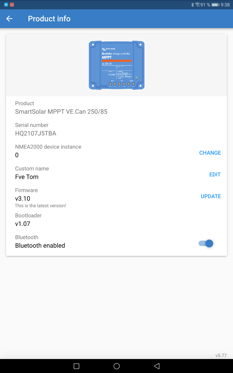

Taky vyzkoušej reset BT na telefonu, případně jiný typ telefonu s BT.5.4. Disabling and enabling Bluetooth
Bluetooth is by default enabled. It can be disabled or enabled via the VictronConnect App.
To disable or enable Bluetooth:
• Connect with the VictronConnect App to the solar charger. Note that if Bluetooth has been disabled, a connection via its built-in
Bluetooth is not possible anymore. In that case use the VE.Direct to USB interface, the VE.Direct Bluetooth Smart dongle or
VRM to connect to the solar charger.
• Select the solar charger from the VictronConnect list.
• Navigate to the solar charger settings page by clicking the cog symbol
• Navigate to the product info page by clicking on the 3 dot symbol
in the top right hand corner.
• Enable or disable the Bluetooth setting.
• In case of disabling Bluetooth, tick the checkbox confirming you understand that once Bluetooth has been disabled, a Bluetooth
connection with the solar charger is not possible anymore.
