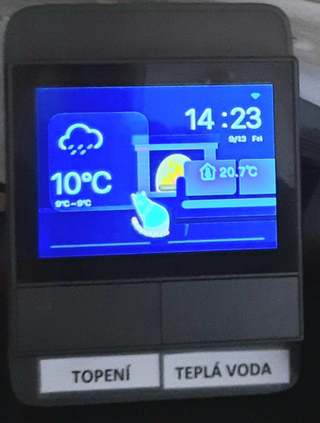

Tohle by ve finale uplne stacilo kdyz clovek vychyta teploty.
