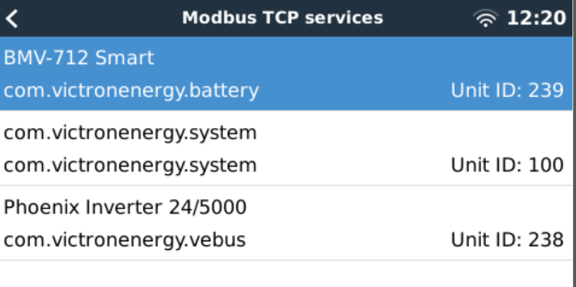

Trapim sa tu s tou Victron integraciu a nejde to:
https://github.com/lucode/home-assistant
Nakopiroval som vsetky adresare aj yaml subory.
A pise mi:
A pise mi:

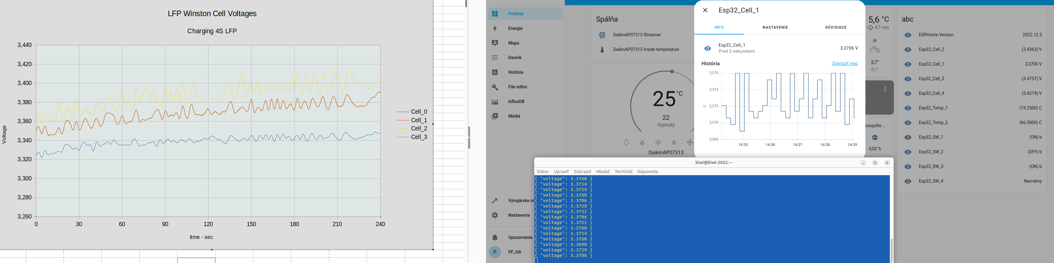

Tak konecne sa mi podarilo do grafu dostat hodnotu a nie retazec.
Kod HA: / configuration.yaml /
KOd ESP322:
. KOnecne to ukazuje to co chcem, teraz sa naucit robit automatizacie a skripty.
Kód: Vybrat vše
mqtt:
sensor:
- name: Esp32_Cell_1
state_topic: "esp32/V1"
unique_id: Esp32V1
unit_of_measurement: "V"
value_template: "{{ value_json.voltage }}"
Kód: Vybrat vše
// Publish an MQTT message on topic esp32/V1
s = "{ ";
s = s + "\"voltage\""+": ";
s = s + String(cell0,4);
s = s + " }";
uint16_t packetIdPub1 = mqttClient.publish(MQTT_V1, 1, true, s.c_str());
// Serial.printf("Publishing on topic %s at QoS 1, packetId: %i", MQTT_V1, packetIdPub1);
// Serial.printf("Message: %.2f \n", cell0);

Veci z ESP32 + MQTT funguju, veci z parametrov HW funguju
ale veci z Victron integracie stale ukazuju nuly ???
