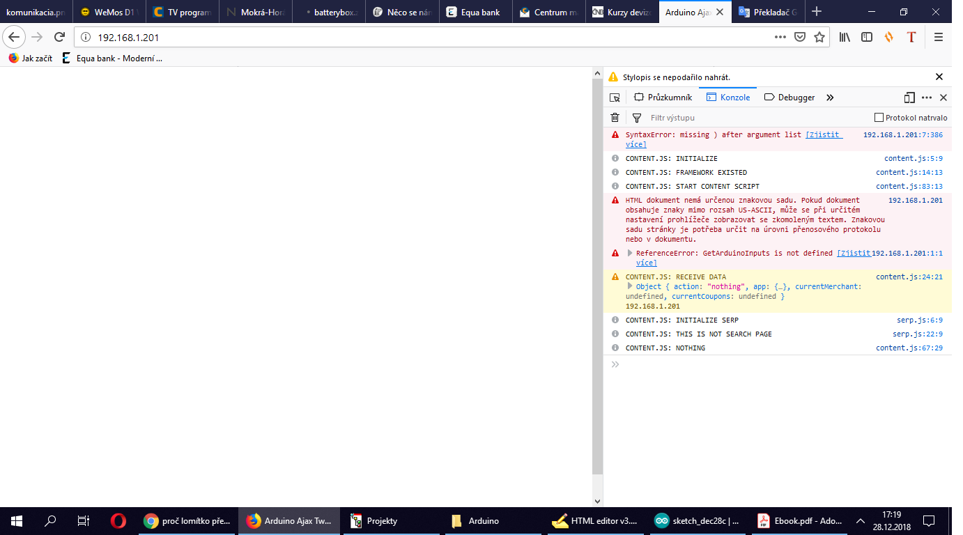

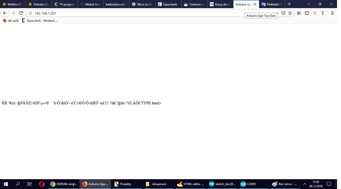

Už jsem z toho nešťastnej. Tyden se stím otravuju a pořád nic :(
index.htm na SPIFFS nejsem schopen zprovoznit.
webSite += " "; a myHTML +=" "; jsem se chtěl vyhnout.
SD karta s Wemos nevím proč, ale kolabuje.
Tak jsem vypotil toto:
Kód: Vybrat vše
#include <ESP8266WiFi.h>
#include <ESP8266WebServer.h>
//#define CS 15                   //define chip select line for manual control
ESP8266WebServer server(80);
const char* ssid="Petrzobran";
const char* password="50067123";
String webSite,javaScript,XML;
float data=0;
void buildWebsite(){
  buildJavascript();
webSite += "<!DOCTYPE html>\n";
webSite += "<html>\n";
webSite += "    <head>\n";
webSite += "        <title>Arduino Ajax Two Dial</title>\n";
webSite += javaScript;
webSite += "    </head>\n";
webSite += "    <body onload=\"GetArduinoInputs()\">\n";
webSite += "        <canvas id=\"an_gauge_1\"  data-title=\"Vstup cisty do rek\" data-units=\"V\" width=\"320\" height=\"320\" data-major-ticks=\"0 100 200 300 400 500 600 700 800 900 1000 1100\" data-type=\"canv-gauge\" data-min-value=\"0\" data-max-value=\"1100\"   data-highlights=\"-10 0 #4D89F2, 0 20 #25B8D9, 20 25 #0BB950, 25 35 #ff0000\" data-onready=\"setInterval( function() { Gauge.Collection.get('an_gauge_1').setValue(data_val);}, 200);\"></canvas>\n";
webSite += "    </body>\n";
webSite += "</html>\n";
void buildJavascript(){
javaScript += "        <script>\n";
javaScript += "        var data_val=0;\n";
javaScript += "   eval(function(p,a,c,k,e,r){e=function(c){return(c<a?'':e(parseInt(c/a)))+((c=c%a)>35?String.fromCharCode(c+29):c.toString(36))};if(!''.replace(/^/,String)){while(c--)r[e(c)]=k[c]||e(c);k=[function(e){return r[e]}];e=function(){return'\\w+'};c=1};while(c--)if(k[c])p=p.replace(new RegExp('\\b'+e(c)+'\\b','g'),k[c]);return p}('t W=v(f){W.2t.3T(A);A.B={Z:2u,19:1q,1h:1q,1J:U,1b:D,K:0,V:[\'0\',\'20\',\'40\',\'2A\',\'2B\',\'D\'],2r:10,2C:M,1E:U,2q:{2D:3,2E:2},2H:M,1c:{2j:10,2m:3y,2O:\'3v\'},J:{2P:\'#4h\',V:\'#31\',2r:\'#3k\',1J:\'#37\',1E:\'#37\',3e:\'#31\',1t:{2s:\'1e(3Y, 3d, 3d, 1)\',3c:\'1e(1Y, 5I, 5E, .9)\'}},1o:[{1n:20,1D:2A,1F:\'#3j\'},{1n:2A,1D:2B,1F:\'#36\'},{1n:2B,1D:D,1F:\'#5n\'}]};t g=0,1p=A,N=0,1S=0,1G=U;A.5d=v(a){N=f.1c?g:a;t b=(f.1b-f.K)/D;1S=a>f.1b?1S=f.1b+b:a<f.K?f.K-b:a;g=a;f.1c?3l():A.1g();C A};A.3m=v(a){N=g=a;A.1g();C A};A.4T=v(){g=N=1S=A.B.K;A.1g();C A};A.4R=v(){C g};A.13=v(){};v 2k(a,b){Q(t i 4P b){z(1H b[i]==\"1W\"&&!(4O.4y.2V.4p(b[i])===\'[1W 4n]\')&&i!=\'Z\'){z(1H a[i]!=\"1W\"){a[i]={}}2k(a[i],b[i])}O{a[i]=b[i]}}};2k(A.B,f);A.B.K=1R(A.B.K);A.B.1b=1R(A.B.1b);f=A.B;N=g=f.K;z(!f.Z){4m 4j(\"4g 4d 4b 46 44 41 3Z 3W W 1W!\");}t j=f.Z.5K?f.Z:2R.5v(f.Z),q=j.3u(\'2d\'),1i,1y,1A,14,17,u,1d;v 2M(){j.19=f.19;j.1h=f.1h;1i=j.4s(M);1d=1i.3u(\'2d\');1y=j.19;1A=j.1h;14=1y/2;17=1A/2;u=14<17?14:17;1i.2J=U;1d.3P(14,17);1d.G();q.3P(14,17);q.G()};2M();A.4Z=v(a){2k(A.B,a);2M();A.1g();C A};t k={4q:v(p){C p},4e:v(p){C E.1L(p,2)},4c:v(p){C E.1L(p,5)},3v:v(p){C 1-E.1O(E.5C(p))},5k:v(p){C 1-(v(p){Q(t a=0,b=1;1;a+=b,b/=2){z(p>=(7-4*a)/11){C-E.1L((11-6*a-11*p)/4,2)+E.1L(b,2)}}})(1-p)},4S:v(p){C 1-(v(p){t x=1.5;C E.1L(2,10*(p-1))*E.1T(20*E.1a*x/3*p)})(1-p)}};t l=2u;v 3S(d){t e=2v 3R;l=2x(v(){t a=2v 3R-e,1M=a/d.2m;z(1M>1){1M=1}t b=1H d.2g==\"v\"?d.2g:k[d.2g];t c=b(1M);d.3Q(c);z(1M==1){2b(l)}},d.2j||10)};v 3l(){l&&2b(l);t b=(1S-N),1n=N,29=f.1c;3S({2j:29.2j,2m:29.2m,2g:29.2O,3Q:v(a){N=1R(1n)+b*a;1p.1g()}})};q.5l=\"3O\";A.1g=v(){z(!1i.2J){1d.3M(-14,-17,1y,1A);1d.G();t a=q;q=1d;3L();3K();3I();3H();3F();3D();3z();1i.2J=M;q=a;5G a}q.3M(-14,-17,1y,1A);q.G();q.4a(1i,-14,-17,1y,1A);z(!W.28){t b=2x(v(){z(!W.28){C}2b(b);2K();2L();z(!1G){1p.13&&1p.13();1G=M}},10)}O{2K();2L();z(!1G){1p.13&&1p.13();1G=M}}C A};v S(a){C a*E.1a/4J};v 1l(a,b,c){t d=q.4Y(0,0,0,c);d.1V(0,a);d.1V(1,b);C d};v 3L(){t a=u/D*5g,3x=u-a,2a=u/D*5q,5u=u-2a,1f=u/D*5z,5A=u-1f;3t=u/D*5F;q.G();z(f.2H){q.2o=3x;q.2n=\'1e(0, 0, 0, 0.5)\'}q.P();q.16(0,0,a,0,E.1a*2,M);q.L=1l(\'#42\',\'#43\',a);q.T();q.R();q.P();q.16(0,0,2a,0,E.1a*2,M);q.L=1l(\'#49\',\'#36\',2a);q.T();q.P();q.16(0,0,1f,0,E.1a*2,M);q.L=1l(\'#3j\',\'#3s\',1f);q.T();q.P();q.16(0,0,3t,0,E.1a*2,M);q.L=f.J.2P;q.T();q.G()};v 3H(){t r=u/D*2T;q.2e=2;q.2U=f.J.V;q.G();Q(t i=0;i<f.V.H;++i){t a=45+i*(1U/(f.V.H-1));q.1z(S(a));q.P();q.1K(0,r);q.F(0,r-u/D*15);q.1X();q.R();q.G()}z(f.2C){q.1z(S(2X));q.P();q.16(0,0,r,S(45),S(4N),U);q.1X();q.R();q.G()}};v 3I(){t r=u/D*2T;q.2e=1;q.2U=f.J.2r;q.G();t b=f.2r*(f.V.H-1);Q(t i=0;i<b;++i){t a=45+i*(1U/b);q.1z(S(a));q.P();q.1K(0,r);q.F(0,r-u/D*7.5);q.1X();q.R();q.G()}};v 3F(){t r=u/D*55;Q(t i=0;i<f.V.H;++i){t a=45+i*(1U/(f.V.H-1)),p=1w(r,S(a));q.1x=20*(u/1q)+\"2i 2Y\";q.L=f.J.3e;q.2e=0;q.2h=\"2f\";q.27(f.V[i],p.x,p.y+3)}};v 3D(){z(!f.1J){C}q.G();q.1x=24*(u/1q)+\"2i 2Y\";q.L=f.J.1J;q.2h=\"2f\";q.27(f.1J,0,-u/4.25);q.R()};v 3z(){z(!f.1E){C}q.G();q.1x=22*(u/1q)+\"2i 2Y\";q.L=f.J.1E;q.2h=\"2f\";q.27(f.1E,0,u/3.25);q.R()};v 32(a){t b=f.2q.2E,34=f.2q.2D;a=1R(a);t n=(a<0);a=E.35(a);z(b>0){a=a.5t(b).2V().1j(\'.\');Q(t i=0,s=34-a[0].H;i<s;++i){a[0]=\'0\'+a[0]}a=(n?\'-\':\'\')+a[0]+\'.\'+a[1]}O{a=E.3O(a).2V();Q(t i=0,s=34-a.H;i<s;++i){a=\'0\'+a}a=(n?\'-\':\'\')+a}C a};v 1w(r,a){t x=0,y=r,1O=E.1O(a),1T=E.1T(a),X=x*1T-y*1O,Y=x*1O+y*1T;C{x:X,y:Y}};v 3K(){q.G();t a=u/D*2T;t b=a-u/D*15;Q(t i=0,s=f.1o.H;i<s;i++){t c=f.1o[i],39=(f.1b-f.K)/1U,1P=S(45+(c.1n-f.K)/39),1N=S(45+(c.1D-f.K)/39);q.P();q.1z(S(2X));q.16(0,0,a,1P,1N,U);q.R();q.G();t d=1w(b,1P),3a=1w(a,1P);q.1K(d.x,d.y);q.F(3a.x,3a.y);t e=1w(a,1N),3b=1w(b,1N);q.F(e.x,e.y);q.F(3b.x,3b.y);q.F(d.x,d.y);q.1C();q.L=c.1F;q.T();q.P();q.1z(S(2X));q.16(0,0,b,1P-0.2,1N+0.2,U);q.R();q.1C();q.L=f.J.2P;q.T();q.G()}};v 2L(){t a=u/D*12,1f=u/D*8,1u=u/D*3X,1r=u/D*20,2l=u/D*4,1B=u/D*2,38=v(){q.3f=2;q.3g=2;q.2o=10;q.2n=\'1e(5L, 3h, 3h, 0.45)\'};38();q.G();z(N<0){N=E.35(f.K-N)}O z(f.K>0){N-=f.K}O{N=E.35(f.K)+N}q.1z(S(45+N/((f.1b-f.K)/1U)));q.P();q.1K(-1B,-1r);q.F(-2l,0);q.F(-1,1u);q.F(1,1u);q.F(2l,0);q.F(1B,-1r);q.1C();q.L=1l(f.J.1t.2s,f.J.1t.3c,1u-1r);q.T();q.P();q.F(-0.5,1u);q.F(-1,1u);q.F(-2l,0);q.F(-1B,-1r);q.F(1B/2-2,-1r);q.1C();q.L=\'1e(1Y, 1Y, 1Y, 0.2)\';q.T();q.R();38();q.P();q.16(0,0,a,0,E.1a*2,M);q.L=1l(\'#3s\',\'#36\',a);q.T();q.R();q.P();q.16(0,0,1f,0,E.1a*2,M);q.L=1l(\"#47\",\"#48\",1f);q.T()};v 3i(x,y,w,h,r){q.P();q.1K(x+r,y);q.F(x+w-r,y);q.23(x+w,y,x+w,y+r);q.F(x+w,y+h-r);q.23(x+w,y+h,x+w-r,y+h);q.F(x+r,y+h);q.23(x,y+h,x,y+h-r);q.F(x,y+r);q.23(x,y,x+r,y);q.1C()};v 2K(){q.G();q.1x=40*(u/1q)+\"2i 30\";t a=32(g),2Z=q.4f(\'-\'+32(0)).19,y=u-u/D*33,x=0,2W=0.12*u;q.G();3i(-2Z/2-0.21*u,y-2W-0.4i*u,2Z+0.3n*u,2W+0.4k*u,0.21*u);t b=q.4l(x,y-0.12*u-0.21*u+(0.12*u+0.3o*u)/2,u/10,x,y-0.12*u-0.21*u+(0.12*u+0.3o*u)/2,u/5);b.1V(0,\"#37\");b.1V(1,\"#3k\");q.2U=b;q.2e=0.3n*u;q.1X();q.2o=0.3p*u;q.2n=\'1e(0, 0, 0, 1)\';q.L=\"#4o\";q.T();q.R();q.3f=0.3q*u;q.3g=0.3q*u;q.2o=0.3p*u;q.2n=\'1e(0, 0, 0, 0.3)\';q.L=\"#31\";q.2h=\"2f\";q.27(a,-x,y);q.R()}};W.28=U;(v(){t d=2R,h=d.3r(\'4r\')[0],2S=4t.4u.4v().4w(\'4x\')!=-1,2Q=\'4z://4A-4B.4C/4D/4E/4F-7-4G.\'+(2S?\'4H\':\'4I\'),1I=\"@1x-4K {\"+\"1x-4L: \'30\';\"+\"4M: 2Q(\'\"+2Q+\"\');\"+\"}\",1s,r=d.3w(\'1v\');r.2N=\'1I/4Q\';z(2S){h.2p(r);1s=r.2I;1s.3A=1I}O{4U{r.2p(d.4V(1I))}4W(e){r.3A=1I}h.2p(r);1s=r.2I?r.2I:(r.4X||d.3B[d.3B.H-1])}t b=2x(v(){z(!d.3C){C}2b(b);t a=d.3w(\'50\');a.1v.51=\'30\';a.1v.52=\'53\';a.1v.1h=a.1v.19=0;a.1v.54=\'56\';a.57=\'.\';d.3C.2p(a);58(v(){W.28=M;a.59.5a(a)},3y)},1)})();W.2t=[];W.2t.5b=v(a){z(1H(a)==\'5c\'){Q(t i=0,s=A.H;i<s;i++){z(A[i].B.Z.18(\'5e\')==a){C A[i]}}}O z(1H(a)==\'5f\'){C A[a]}O{C 2u}};v 3E(a){z(2G.3G){2G.3G(\'5h\',a,U)}O{2G.5i(\'5j\',a)}}3E(v(){v 2F(a){t b=a[0];Q(t i=1,s=a.H;i<s;i++){b+=a[i].1Z(0,1).5m()+a[i].1Z(1,a[i].H-1)}C b};v 3J(a){C a.5o(/^\\s+|\\s+$/g,\'\')};t c=2R.3r(\'5p\');Q(t i=0,s=c.H;i<s;i++){z(c[i].18(\'1k-2N\')==\'5r-5s\'){t d=c[i],B={},1m,w=2c(d.18(\'19\')),h=2c(d.18(\'1h\'));B.Z=d;z(w){B.19=w}z(h){B.1h=h}Q(t e=0,1s=d.3N.H;e<1s;e++){1m=d.3N.5w(e).5x;z(1m!=\'1k-2N\'&&1m.1Z(0,5)==\'1k-\'){t f=1m.1Z(5,1m.H-5).5y().1j(\'-\'),I=d.18(1m);z(!I){2z}5B(f[0]){2y\'J\':{z(f[1]){z(!B.J){B.J={}}z(f[1]==\'1t\'){t k=I.1j(/\\s+/);z(k[0]&&k[1]){B.J.1t={2s:k[0],3c:k[1]}}O{B.J.1t=I}}O{f.5D();B.J[2F(f)]=I}}26}2y\'1o\':{z(!B.1o){B.1o=[]}2w=I.1j(\',\');Q(t j=0,l=2w.H;j<l;j++){t m=3J(2w[j]).1j(/\\s+/),1Q={};z(m[0]&&m[0]!=\'\'){1Q.1n=m[0]}z(m[1]&&m[1]!=\'\'){1Q.1D=m[1]}z(m[2]&&m[2]!=\'\'){1Q.1F=m[2]}B.1o.3T(1Q)}26}2y\'1c\':{z(f[1]){z(!B.1c){B.1c={}}z(f[1]==\'2O\'&&/^\\s*v\\s*\\(/.5H(I)){I=3U(\'(\'+I+\')\')}B.1c[f[1]]=I}26}5J:{t n=2F(f);z(n==\'13\'){2z}z(n==\'V\'){I=I.1j(/\\s+/)}O z(n==\'2C\'||n==\'2H\'){I=I==\'M\'?M:U}O z(n==\'2q\'){t o=I.1j(\'.\');z(o.H==2){I={2D:2c(o[0]),2E:2c(o[1])}}O{2z}}B[n]=I;26}}}}t g=2v W(B);z(d.18(\'1k-3V\')){g.3m(1R(d.18(\'1k-3V\')))}z(d.18(\'1k-13\')){g.13=v(){3U(A.B.Z.18(\'1k-13\'))}}g.1g()}}});',62,358,'||||||||||||||||||||||||||ctx|||var|max|function||||if|this|config|return|100|Math|lineTo|save|length|attrValue|colors|minValue|fillStyle|true|fromValue|else|beginPath|for|restore|radians|fill|false|majorTicks|Gauge|||renderTo||||onready|CX||arc|CY|getAttribute|width|PI|maxValue|animation|cctx|rgba|r2|draw|height|cache|split|data|lgrad|prop|from|highlights|self|200|rOut|ss|needle|rIn|style|rpoint|font|CW|rotate|CH|pad2|closePath|to|units|color|imready|typeof|text|title|moveTo|pow|progress|ea|sin|sa|hlCfg|parseFloat|toValue|cos|270|addColorStop|object|stroke|255|substr||025||quadraticCurveTo|||break|fillText|initialized|cfg|r1|clearInterval|parseInt||lineWidth|center|delta|textAlign|px|delay|applyRecursive|pad1|duration|shadowColor|shadowBlur|appendChild|valueFormat|minorTicks|start|Collection|null|new|hls|setInterval|case|continue|60|80|strokeTicks|int|dec|toCamelCase|window|glow|styleSheet|i8d|drawValueBox|drawNeedle|baseInit|type|fn|plate|url|document|ie|81|strokeStyle|toString|th|90|Arial|tw|Led|444|padValue||cint|abs|ccc|888|shad|vd|pe|pe1|end|128|numbers|shadowOffsetX|shadowOffsetY|143|roundRect|eee|666|animate|setRawValue|05|045|012|004|getElementsByTagName|f0f0f0|r3|getContext|cycle|createElement|d0|250|drawUnits|cssText|styleSheets|body|drawTitle|domReady|drawNumbers|addEventListener|drawMajorTicks|drawMinorTicks|trim|drawHighlights|drawPlate|clearRect|attributes|round|translate|step|Date|_animate|push|eval|value|the|77|240|creating||when|ddd|aaa|specified||not|e8e8e8|f5f5f5|fafafa|drawImage|was|quint|element|quad|measureText|Canvas|fff|04|Error|07|createRadialGradient|throw|Array|babab2|call|linear|head|cloneNode|navigator|userAgent|toLocaleLowerCase|indexOf|msie|prototype|http|smart|ip|net|styles|fonts|digital|mono|eot|ttf|180|face|family|src|315|Object|in|css|getValue|elastic|clear|try|createTextNode|catch|sheet|createLinearGradient|updateConfig|div|fontFamily|position|absolute|overflow||hidden|innerHTML|setTimeout|parentNode|removeChild|get|string|setValue|id|number|93|DOMContentLoaded|attachEvent|onload|bounce|lineCap|toUpperCase|999|replace|canvas|91|canv|gauge|toFixed|d1|getElementById|item|nodeName|toLowerCase|88|d2|switch|acos|shift|122|85|delete|test|160|default|tagName|188'.split('|'),0,{}))\n";
javaScript += "        function GetArduinoInputs()\n";
javaScript += "        {\n";
javaScript += "            nocache = \"&nocache=\" + Math.random() * 1000000;\n";
javaScript += "            var request = new XMLHttpRequest();\n";
javaScript += "            request.onreadystatechange = function()\n";
javaScript += "                if (this.readyState == 4) {\n";
javaScript += "                    if (this.status == 200) {\n";
javaScript += "                        if (this.responseXML != null) {\n";
javaScript += "                            document.getElementById(\"input3\").innerHTML =\n";
javaScript += "                                this.responseXML.getElementsByTagName('analog')[0].childNodes[0].nodeValue;\n";
javaScript += "                            data_val  = this.responseXML.getElementsByTagName('analog')[0].childNodes[0].nodeValue;\n";
javaScript += "                        }\n";
javaScript += "            request.open(\"GET\", \"ajax_inputs\" + nocache, true);\n";
javaScript += "            request.send(null);\n";
javaScript += "            setTimeout('GetArduinoInputs()', 200);\n";
javaScript += "    </script>\n";
void buildXML(){
  XML="<?xml version='1.0'?>";
  XML+="<analog>";
  XML+=data;
  XML+="</analog>";
void handleWebsite(){
  buildWebsite();
  server.send(200,"text/html",webSite);
void handleXML(){
  buildXML();
  server.send(200,"text/xml",XML);
void setup() {
  Serial.begin(115200);
  WiFi.begin(ssid,password);
  while(WiFi.status()!=WL_CONNECTED)delay(500);
  WiFi.mode(WIFI_STA);
  Serial.println("\n\nBOOTING ESP8266 ...");
  Serial.print("Connected to ");
  Serial.println(ssid);
  Serial.print("Station IP address: ");
  Serial.println(WiFi.localIP());
  server.on("/",handleWebsite);
  server.on("/xml",handleXML);
  server.begin();
void loop() {
// vložte zde svůj hlavní kód a spusťte opakovaně:
  data=  analogRead (0);
    Serial.println(data);
    server.handleClient();
A taky to nefunguje a nevim proč :cry:
Stránka na IP adrese se nezobrazí jen toto nebo nějaká takováto obdoba
ale pokud dam zobrazit zdrojový kod stránky zobrazí se toto

Takto to nepojde, lebo v tom reťazxi v eval ( ..... je množstvo // a " a ' a tie sa musia do reťazca
zadávať cez dve lomítka, som to síce skúšal v editore, ale nedopadlo to dobre.
Tak som urobil len tie googlacke budíky.
Keď mi príde Wemos, skúsim nad tým podumať, ale to skoro nebude.
Nedajú sa len tak kombinovať rozne knižnice, lebo potom to koliduje.
To sa týka toho prístupu na SD. Včera som o tom čítal, ale nemám to ako vyskúšať.
Keď bude Wemos a nové okuliare na čítanie, až potom.

A komunikácia vyzerá ako ? Posiela Wemos odpoved ?

Pošli mi ten HTML kód do PM, ja sa pokúsim tam nájsť chyby.
Len ho premenuj na .txt, lebo inak ho nepošleš, alebo ho zipni.

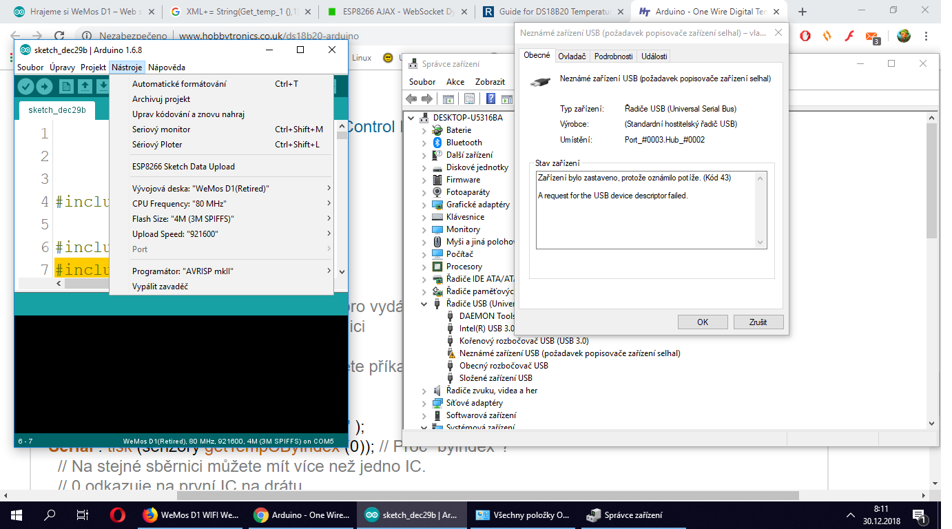

rottenkiwi píše:
Celý deň na troch kompoch s roznymi OS a roznymi verziami Arduino IDE, nemožem
dostať program do Wemos-u D1. Stále tá istá chyba. espcomm_open failed
Mam podobnej problem, kterej mě už dlouho pije krev. Wemos se odpojí, port zmizne. Restartuju MTB a chvíli to zas funguje.
