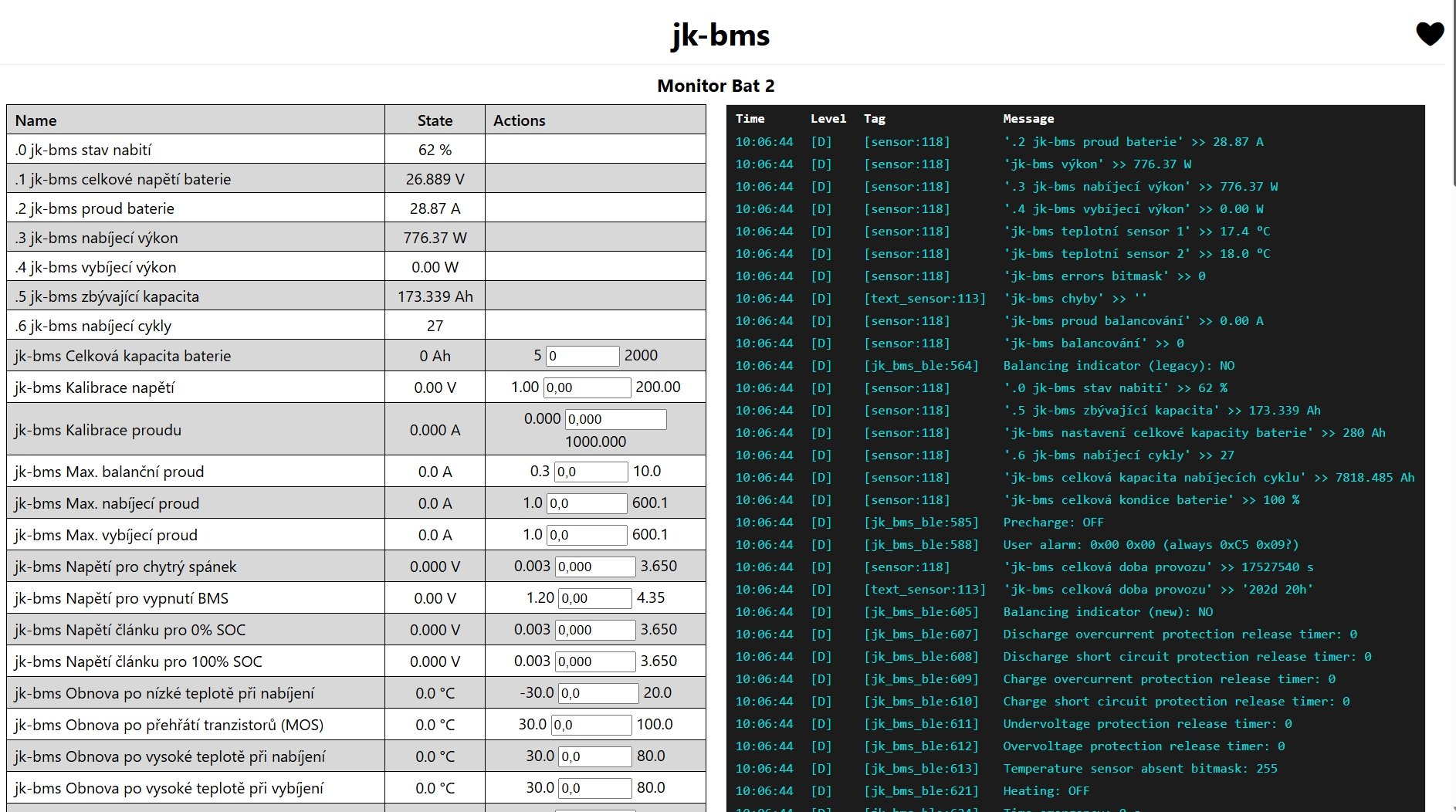

pokud by někdo chtěl soubor yaml na baterii s 8 články a počeštěnou, tak takhle vypadá ta moje. Stačí přepsat:
- svůj název zařízení - Moje bat
- svou wifi - ssid: mojewifi
password: heslo
- svou Mac -XX:XX:XX:XX:XX:XX

[substitutions:
  device_description: "Moje bat"
  external_components_source: github://syssi/esphome-jk-bms@main
  mac_address: XX:XX:XX:XX:XX:XX
  # Please use "JK02_24S" if you own a old JK-BMS < hardware version 11.0 (hardware version >= 6.0 and < 11.0)
  # Please use "JK02_32S" if you own a new JK-BMS >= hardware version 11.0 (f.e. JK-B2A8S20P hw 11.XW, sw 11.26)
  # Please use "JK04" if you have some old JK-BMS <= hardware version 3.0 (f.e. JK-B2A16S hw 3.0, sw. 3.3.0)
  protocol_version: JK02_32S
esphome:
  min_version: 2024.6.0
  project:
    version: 2.3.0
esp32:
  board: wemos_d1_mini32
  framework:
    type: esp-idf
external_components:
  - source: ${external_components_source}
    refresh: 0s
wifi:
  ssid: mojewifi
  password: heslo
web_server:
  port: 80
  version: 2
ota:
  platform: esphome
  on_begin:
    then:
      - switch.turn_off: ble_client_switch0
      - logger.log: "BLE connection suspended for OTA update"
logger:
  level: DEBUG
  logs:
    esp32_ble_tracker: INFO
    esp32_ble_client: INFO
# If you don't use Home Assistant please remove this `api` section and uncomment the `mqtt` component!
api:
# mqtt:
#   broker: !secret mqtt_host
#   username: !secret mqtt_username
#   password: !secret mqtt_password
#   id: mqtt_client
esp32_ble_tracker:
  scan_parameters:
    active: false
ble_client:
  - mac_address: ${mac_address}
jk_bms_ble:
  - ble_client_id: client0
    protocol_version: ${protocol_version}
    throttle: 10s
binary_sensor:
  - platform: jk_bms_ble
    balancing:
      name: "${name} balancování"
    charging:
      name: "${name} nabíjení"
    discharging:
      name: "${name} vybíjení"
    heating:
    online_status:
      name: "${name} stav online"
    dry_contact_1:
      name: "${name} bezpotenciálový kontakt 1"

      náhled:[attachment=0]náhled bat.jpg[/attachment]
