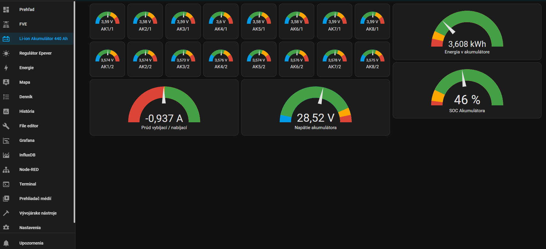

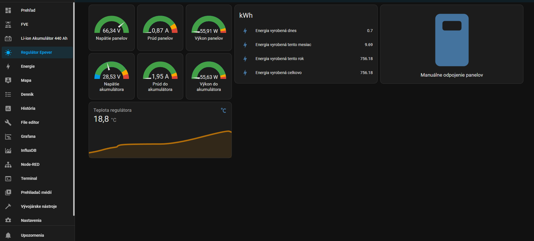

Zdravým, vedel by mi niekto poradiť ako v HA nastavím jednotky v tomto prehľade údajov?
Keď si dám upraviť, tak tam takú možnosť nemám.
V ďalších oknách sa mi to dalo nastaviť.
Ďakujem

Re: Home Assistant
povolene jednotky v home assistant definuje subor
/core/homeassistant/const.py (aka konstanty)
https://github.com/home-assistant/core/ ... st.py#L384
napriklad (kusok z horeuvedeho suboru)
# #### UNITS OF MEASUREMENT ####
# Power units
POWER_WATT = "W"
POWER_KILO_WATT = "kW"
# Voltage units
VOLT = "V"
# Energy units
ENERGY_WATT_HOUR = "Wh"
ENERGY_KILO_WATT_HOUR = "kWh"
# Electrical units
ELECTRICAL_CURRENT_AMPERE = "A"
ELECTRICAL_VOLT_AMPERE = "VA"
zvolena jednotka je pre danu entitu a jej state zobrazovana automaticky. Ale LEN ak je definovana. Casto definovana nie je. Vtedy je pomoc jednoducha, otvorime si file editorom subor configuration.yaml alebo sensor.yaml a pozreme sa, ci je pre danu jednotku zadana direktiva
Uvediem priklad:
# Power units
POWER_WATT = "W"
# Voltage units
VOLT = "V"
# Energy units
# Electrical units
Kód: Vybrat vše
unite_of_measurement
Kód: Vybrat vše
- platform: template
sensors:
battery_power:
value_template: '{{ states.sensor.studer.attributes["battery"]["power"] }}'
device_class: battery
unit_of_measurement: 'kW'
unique_id: battery_power
battery_voltage:
value_template: '{{ states.sensor.studer.attributes["battery"]["voltage"] }}'
unit_of_measurement: 'V'
unique_id: battery_voltage
battery_current:
value_template: '{{ states.sensor.studer.attributes["battery"]["current"] }}'
unit_of_measurement: 'A'
unique_id: battery_current
battery_soc:
value_template: '{{ states.sensor.studer.attributes["battery"]["soc"] }}'
unit_of_measurement: '%'
unique_id: battery_soc
battery_temperature:
value_template: '{{ states.sensor.studer.attributes["battery"]["temperature"] }}'
device_class: temperature
unit_of_measurement: '°C'
unique_id: battery_temperature
battery_has_bsp:
value_template: '{{ states.sensor.studer.attributes["battery"]["hasBatteryStatusProcessor"] }}'
unit_of_measurement: ''
unique_id: battery_has_bsp
- mgx
- Příspěvky: 589
- Reputace: 116
- Výkon panelů [Wp]: 30000
- Kapacita baterie [kWh]: 100
- Bydliště: Tatranska Lomnica
- mgx
- Příspěvky: 589
- Reputace: 116
Re: Home Assistant
Vsetky povolene jednodky (unit_of_measurement) najdes v subore const.py
jeho kopia je aj na github(e), staci kliknut sem
tieto dva subory su identicke.
Ak ti nejde otvorit subor config.py vo file editore, treba si nainstalovat rozsirenie visual studio code (aj tak je lepsie) a dodat novy adresar /core/homeassistant postup ako sa to robi je v mojich videach, visual studio code v #1, pridanie adresara v #5.2
Na dodanie unit_of_measurement netreba ani jedno z nich. Klikni vlavo na zalozku Developer Tools (kladivo) a hore na tab States (Stavy)
vyber si entitu ktoru chces upravit alebo urob novu (poznamka. ak chcem novu,len do okienka napisem jej meno, napr. sensor.moja_nova_entita)
zobrazia sa ti vsetky platne entity, ktore mas. Kliknes na tu, ktoru chces upravit
do casti Additional Components (YAML/Optional) doplnis
namiesto kWh mozes pouzit hocico
Kliknes SET. Entita sa zmeni
Ked potom otvoris kartu, vidis entitu aj s jednotkou. Alternativne sa da jednotka doplnit aj tu. vid obrazok
ulozis, a pozres vysledok
Kód: Vybrat vše
unit_of_measurement: kWh

Re: Home Assistant
Presne takto som postupoval, no tie jednotky mi tam neuloží.
V prehľade údajov sa mi stále zobrazujú údaje bez jednotiek.

Milan, ďakujem za ochotu. Skúšal som to bez diakritiky a medzier, no stále mi tie jednotky neuloží.
No až teraz som si všimol, že tie údaje čo mi idú z LK3 sú niekde ako oddeľovač desatinných miest použité bodky a niekde čiarky, tak či nebude aj v tom problém. No to ja zmeniť neviem.
Zatiaľ to asi nechám takto bez jednotiek v tom prehľade údajov, ale aspoň som si to trochu vyskúšal.
Teraz ako som od 1.12. zmenil zamestnávateľa
(ráno vstanem a mám fajront), mám viac času na zábavky, tak to možno skúsim celé odznovu bez diakritiky a medzier.
Panel 270 Wp ZV
LK3 monitoring
Grafy: Panely 3960 Wp Napätie na akum. Energia v akum. Denný výkon/spotreba
DC/DC menič
LK3 monitoring
DC/DC menič
- Dusan61
- Příspěvky: 341
- Reputace: 112
- Lokalita: Zvolen
- Výkon panelů [Wp]: 3960
- Bydliště: ZV
Re: Home Assistant
Tak som sa trochu pohol ďalej. Vyskúšal som si tú novú entitu zapísať do configuration.yaml a po reštarte HA sa mi to tam už objavilo aj v jednotkách.
Dokonca som do názvu použil aj diakritiku a zobrazuje to dobre. Tak sa môžem zabávať a takto to dopisovať všade kde potrebujem.
Milan, ešte raz ďakujem
