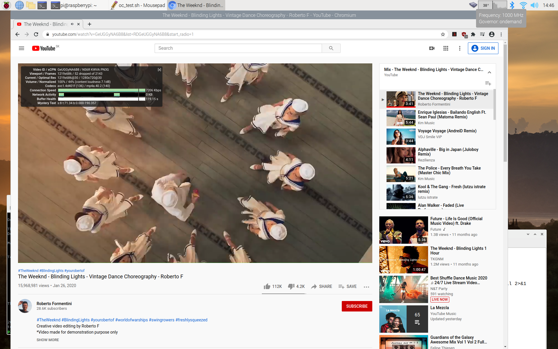

Ja mam sice RPi 4 / 8 GB / 1.5 GHz, ale som ho pretaktoval na 2.0 GHz.
Bez OC to bootne:
Ubuntu 20.10 - 64 bit - arm64 41 sec. SATA SSD
Rasp. Pi - 32 bit - armv7l GNU/Linux 28 sec. uSD
Pri OC ako v config.txt to bootne Rasp. 32-bit z uSD za 21 sec.
Yotube video to prehrava u armv7 s droppend frames ako na obr.
Spotreba pri prehravani UT je pred menicom 18.38 V / 0.49 az 0.56 A, ergo
9.006 az 10.29 W.
Zvuk cez HDMI do monitora IIyama E2607WS ide, OK
podobne aj 3.5 mm Jack OK, u 32 bit Rasp. OS.
U Ubuntu 20.10 64-bit arm64 zvuk cez HDMI nejde, jack OK.
Nastavenia, teplota, freq., benchmark.
Zaujimalo by ma, ako je to u Rasp. 400 bez OC a po OC na 2000 MHz
ohladom spotreby, prime benchmarku, bootu a UT videa.
Bez OC to bootne:
9.006 az 10.29 W.
