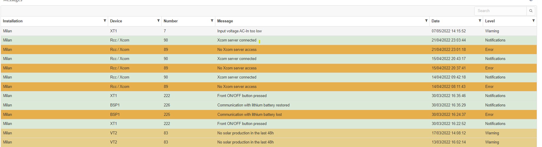

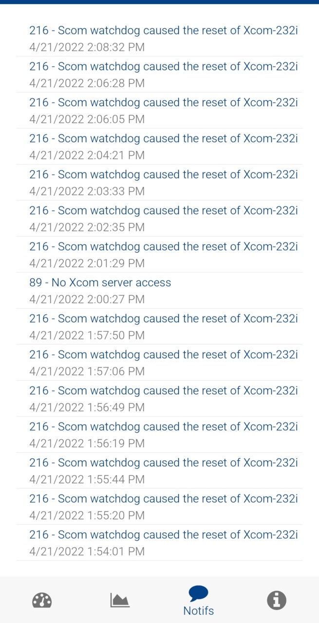

Riesil som nedavno so Studerom tie chyby co ma asi kopec ludi ktori brali zo SecondSol
electronic board in the Xcom232i - ma nejaku vadu, preto chodia tie spravy dokola (vid foto)
Jedine co sa da spravit ze sa "vypnu", co to ale v reale spravi ze nebudu spamovat tie spravy a vypadky pri nacitani stavu nebudu tolko failovat, ale aj tak to na pozadi vlastne stale pada, len uzivatel o tom uz nebude informovany.
Po asi mesiaci co to takto mam, tak apka/portal menej timeoutuje ale stane sa nejaky zasek ked musim dat znova refresh.
Teda bud to vypnete alebo investujete do noveho Xcom-232i, pytali odomna aj SN cislo , zjavne to mali vsetky starsie serie. Co neviem ako ofiko riesia ci menia kus za kus, ale ked som to bral 2nd Hand tak neviem ci sa da nejako uplatnit narok na vymenu vadneho HW.
Please try to change the settings as follow.
{5072} Xcom Portal watchdog activation = Automatic
{5113} Delay before Xcom Portal watchdog forces reconnection 5min -> 15min
{5119} Device identification (LEDs) with the SCOM address = 0
{5095} Enable SCOM watchdog Yes -> NO
{5096} SCOM watchdog delay before reset of Xcom-232i 10 -> 120sec
{5103} Activation of the watchdog hardware (deactivation restarts the Xcom-232i) Yes -> NO
