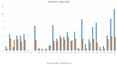

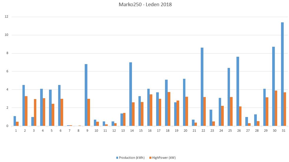

To je jen prvotní nadšení,když stále něco svítí.Příjde prosinec,leden,únor a budeš přemýšlet,kam dát další panely,neboj to přejde.Ale jinak letos od 24.2. stále jedu nonstop bez vypnutí,což je supersezóna!
Tady ale máš výpis za leden,holt těch slabých dnů po sobě je hodně:
Date,kWh,Time,Float Time (h:m),High Power (kW),High Temp (C),Vin,Vbatt,,
1/31/2018,11.4,23:59,00:00,3.714,56.6,143,58,,
1/30/2018,8.7,23:59,00:00,3.905,52.1,139.7,57.8,,
1/29/2018,4.1,23:59,00:00,3.151,49.2,139.8,57,,
1/28/2018,1.3,23:59,00:00,0.53,45.2,130,55.1,,
1/27/2018,1,23:59,00:00,0.323,45.1,130,53.7,,
1/26/2018,7.6,23:59,00:00,2.145,48.2,141.2,56.4,,
1/25/2018,6.4,23:59,00:00,3.202,49,143.2,57.2,,
1/24/2018,3.1,23:59,00:00,2.231,48.2,141.4,56.1,,
1/23/2018,1.8,23:59,00:00,0.502,48.2,135.6,54.5,,
1/22/2018,8.6,23:59,00:00,3.179,48.3,143.7,57.6,,
1/21/2018,0.7,23:59,00:00,0.375,45.2,131.3,53.6,,
1/20/2018,5.2,23:59,00:00,3.22,50.3,141.6,56.5,,
1/19/2018,2.6,23:59,00:00,2.794,48.2,144,56.3,,
1/18/2018,5.1,23:59,00:00,3.743,52.4,142.2,57.1,,
1/17/2018,3.7,23:59,00:00,3.009,48.2,140.2,56.6,,
1/16/2018,4.1,23:59,00:00,3.472,49.5,146.4,56.9,,
1/15/2018,3.3,23:59,00:00,2.649,48.2,140,56.2,,
1/14/2018,7,23:59,00:00,2.601,48.2,140.2,56.8,,
1/13/2018,1.4,23:59,00:00,1.447,48.2,135.3,55.6,,
1/12/2018,0.5,23:59,00:00,0.332,42.9,126.5,54.3,,
1/11/2018,0.5,23:59,00:00,0.193,42.5,123.8,53.8,,
1/10/2018,0.7,23:59,00:00,0.466,47.8,133.1,53.2,,
1/9/2018,6.8,23:59,00:00,3.007,48.2,137.8,57.2,,
1/8/2018,0,23:59,00:00,0.062,34.1,125.5,51.7,,
1/7/2018,0.1,23:59,00:00,0.109,36.2,122.7,51.8,,
1/6/2018,4.5,23:59,00:00,3.01,49.8,136.6,56.5,,
1/5/2018,4,23:59,00:00,2.436,48.2,137,56.4,,
1/4/2018,4.1,23:59,00:00,3.078,49.1,145.6,56.8,,
1/3/2018,1,23:59,00:00,2.963,48.2,140.9,55.2,,
1/2/2018,4.5,23:59,00:00,3.3,50.9,139,56.7,,
1/1/2018,1.1,23:59,00:00,0.468,47.9,127.7,54.9,,

dal jsem ten tvůj log do grafu a není to zas tak špatný: Kolikrát tam máš i výrobu/spotřebu 4kWh...akorát někdy taky kulový dva dny za sebou, to máš pravdu.
Mimochodem, tohle je asi měření na straně panelů viď? Takže po odečtení vlastní spotřeby měničů z toho do baráku dostaneš ještě trochu míň...že?

Tohle je s prvotním polem s maximálkou 5kWp.Nyní jsem přidal pro šedé dny na fasádu 2.8kWp a uvidím jak to v nich zabere.Mám tu často ranní záblesky východu slunce na ně v zimě.
Jo to je z reglu a když potřebuješ denně 13kWh,tak to prostě nejde normálně napanelovat na toto období .Ale trochu se tady zapomíná na to,že ta sezóna s panely nahradí 4.5MWh z potřebných 5 za rok a pro těch pár kWh se nevyplatí už cokoli dělat,dyť je to jen 3000Kč se vším z DS.Proč na to řešit dalších 50kWp a bláznit.Jednodušší je se omezit,ale konkrétně u mě to ještě potrvá ,než dvě různé generace odejdou a zbydeme si jen my s ženou.I tak s ní bude potíž

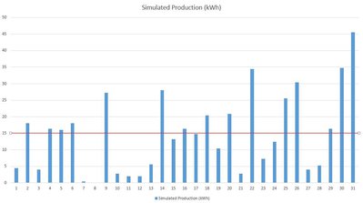

na pankáče jsem to pronásobil 4x (20/5kWp) a vyšla mi tato simulace: Abych se nemusel moc omezovat, spotřebuju každý den cca 15kWh. Možná by šlo 10kWh. Ovšem já měřím na straně AC-out, takže musím připočítat ještě něco málo na ztráty při konverzi, nabíjení a spotřebu mých měničů.
Vypadá to, že některé dny si prostě ani neuvařím kafe, natož konev čaje.
Na to bych potřeboval tak 60kWh v bateriích, což by byl asi nejdražší čajíček na světě

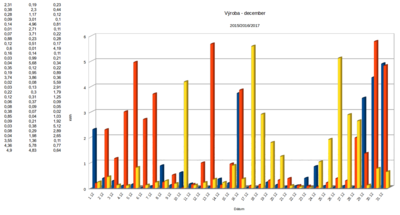

Dúfam, že sa youda nenahnevá, tak sem dám svoje dáta.
2015 - 1 kWp 24 kWh
2016 - 1.5 kWp 47 kWh
2017 - 2 kWp 36 kWh

Jojo ,to je to co myslím,stačí ten čajíček ohřát jinak než el. energií a je to ne
,nebo vytáhnout vychlazenou láhev vína a kašlat i na ten čaj.Onehdy jsem byl v chatě(nové) z druhé strany Lomničáku v PL a nebyl tam signál,ani internet.První den problém,druhý den se ještě někdo koukal na displeje,ale třetí den už nikomu nechyběl.A najednou vyplavou na povrch jiné činnosti a klid.
Jo a je to jako s těmi kalendáři ,co jsi sem postoval. Ještě pojedu tak 10-15x lyžovat a je s lyžováním konec!
